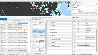

We understand that this is an aged request but wanted to point out that this is what ArcGIS Pro does.
In the example below, note that the domain contains a value of 17 - Volcanic. Even though that value is not present in the attribute table, when the CAUSE field is used to symbolize the layer, note that 17 - Volcanic is included as a symbol class.
wayfaringrob
@KoryKramer  - I tried doing this as recently as last week. I had to add dummy data to my map to prompt symbology to grab my domain classes. What's the workflow you used to get that to happen?
