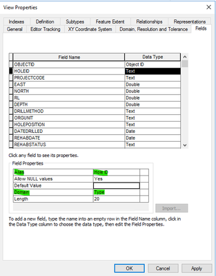

In ArcCatalog it was possible to set the field alias and apply domains in a single interface, in the feature class properties:

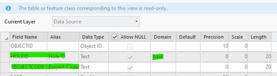

I have just noticed in Pro's equivalent Data Design=>Fields that this function has been removed:
Notice though that Pro still displays these alias and domain settings, so not sure why this wouldn't be supported in data design?

How are you connected to the data source? Normally this works just fine, but your screenshot shows a "this view is read-only" notice.

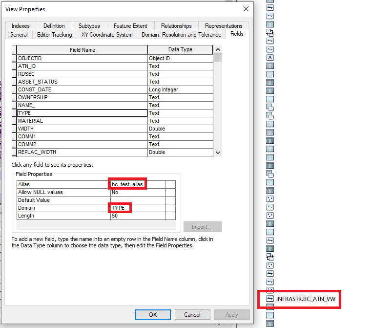

Like you said, with a registered database view, I was able to apply a domain and an alias to a field using ArcCatalog 10.7.1 > Properties:
The domain and alias work as expected in the attribute table in both ArcMap 10.7.1 and ArcGIS Pro 2.9.5.
