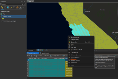

Here is the area with the selection count, it would be nice to be able to show additional information here, allowing the user to see basic information without having to go elsewhere.
2 Comments
KoryKramer
The Data Engineering view might be a good option. You can get there by right-clicking on a field header > Explore statistics
or right-clicking the layer > Data Engineering.
It's a great way to explore data and get quick statistics, including for selections.

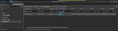

The point of the idea would be to keep the user from having to invoke anything to get the quick info.  It could be a configuration to turn on or off (perhaps in the selection options).  I'm thinking like the MS Excel summary at the bottom that gives you stats on your selection.
Data engineering somewhat does the job in the meanwhile, thanks for the suggestion.  However, it doesn't allow me to select the units to summarize the data in (eg Hectares, SqM, Sqft, etc).  I'd have to add a field, calculate the value, then do the Data Engineering pane.
