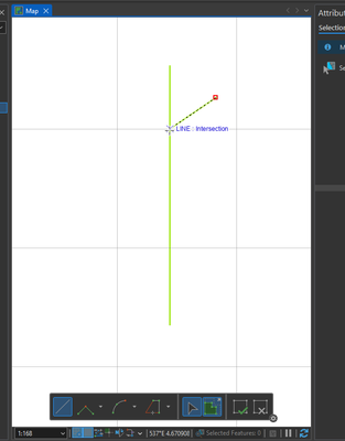

Here I'm snapping to the intersection of the green line and my grid line (gray):

Hi @Scott_Harris ,
it was a problem with the map in my project (but not only in one project and not only one map). Using the featureclass in a new, empty map in a new empty project, snapping the intersection of a feature and a grid line works. Also a new map in the existing project worked.
Is it possible, that there are to many layers in the map? Or maybe a problem with layers from differen datasources?
Is there any way to repair an older project?
