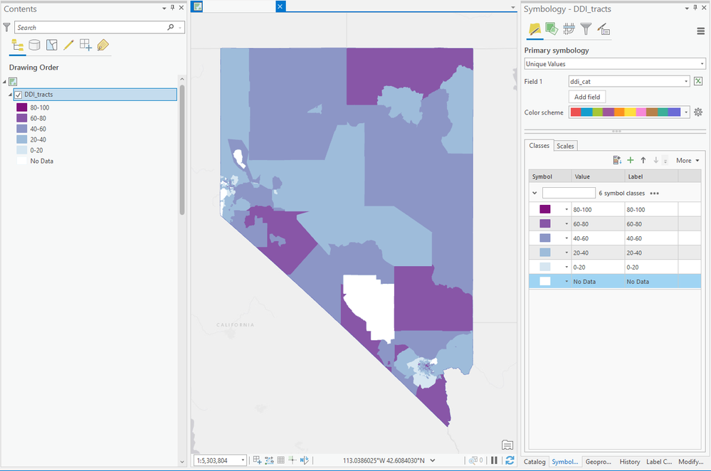

Yet another instance where ESRI comes up short. QGIS handles this much better. My advice is to create a new category column based on the ranges of the values you wish to symbolize and then symbolize based Unique values. For instance, I want to create 5 classes and one "No Data" class. I write the logic (CASE WHEN is a good option) for the classes and just produce the text outputs in a new column (ddi_cat). Screenshot 2022-08-16 121053.pngThis is QGISThis is QGIS
Note I created the new column in QGIS but there is probably a way to do it in ArcPro. In general, I highly recommend getting familiar with QGIS, especially when it comes to symbology. It has superior UI, functionality and customizability. I generally map things out in QGIS and then transfer them over to ArcPro for the web mapping features.

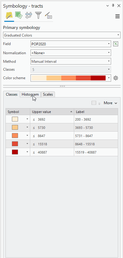

The lower value is shown and editable in the histogram view as shown in this GIF.
The example @lzk222 shows can also be done with an arcade expression for class breaks or unique value symbology. In that case the expression itself is configuring classes.

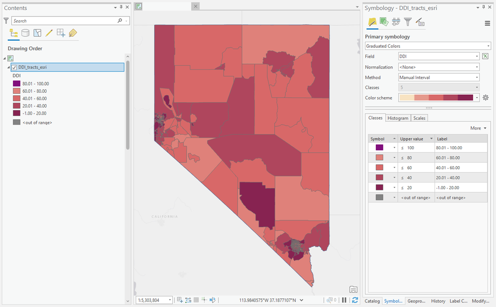

Below is the best that I can do currently:
We could do a lot of modifications to the labels to clean this up but it takes a lot of time and if anything changes, we have to start over again.
