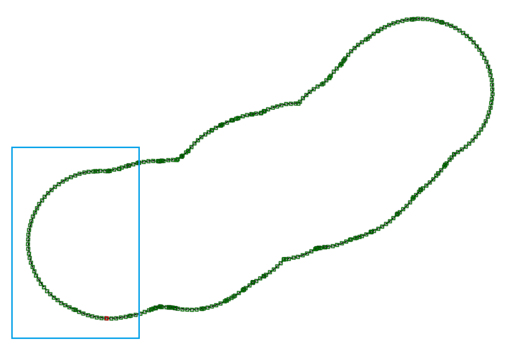

I have a polygon with many vertices. I want to select multiple vertices on the left hand side of the polygon and delete those vertices.
It would be ideal if I could use a rectangle selection tool to select multiple vertices and then delete them.

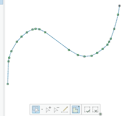

You can do this using the tools provided on the Edit Vertices toolbar.
Key steps: First switch to the Select By Rectangle tool, then switch to the Delete Vertices tool. Now when you drag a selection for deletion, it will constrain to a rectangle.

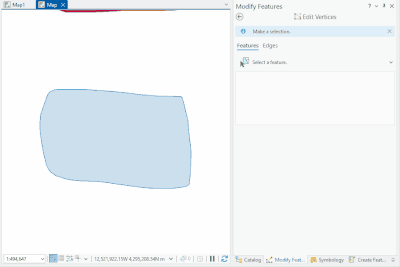

@LisaRandolph_Thurston can you describe what you are seeing happen when you follow what I describe in my comment above and in the provided GIF?
Many aspects are right on - using the rectangle tool, I am able to select a number of vertices, then click the "vertices minus" tool, but they do not get deleted. BUT I just found my work-around: select multiple vertices using the rectangle tool, then hit the Delete key on the keyboard. I am now able to accomplish what I need to do. ArcMap tools worked as described above. ArcGIS Pro just works differently than ArcMap (at least for us old timers). Thanks for asking!
