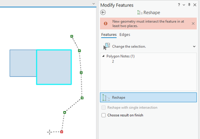

It looks like this has been implemented in Pro 3.x when using the cut tool. Thank you, ESRI. But it seems like this has NOT been implemented when using the reshape tool. Please add that, ESRI!

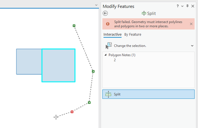

I'm closing this because ArcGIS Pro retains the sketch when a Reshape or Split operation fails.
