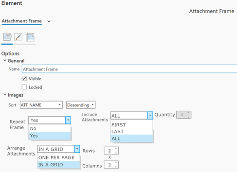

To really improve attachments in reports, I want to have the following attachment handling options:
  • Repeat the Attachment Frame
  • Include variable number of attachments:
    • First #
    • Last #
    • All
  • Arrangement options:  by grid, one per page
    • Grid Size
An example of the enhanced Attachment Frame properties might look like below.

These features have been implemented in Pro 3.7. Now when you add an attachment frame, the Element pane has a few options for you
1. Designate which attachments to export, first x, last x, index, or all (default is all)
2. Grid orientation or one per page
3. Dynamic row option to show all attachments on export
