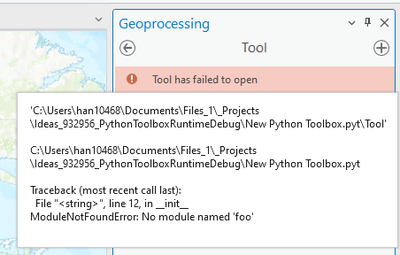

HannesZiegler
Status changed to: Implemented
This is implemented in ArcGIS Pro. When a tool fails at runtime, hover over the error banner to view the error messages.
