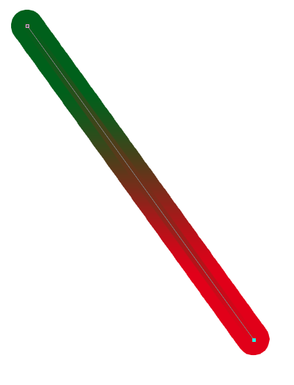

It would be great if a colour gradient could be rotated along a line symbol's length.  There are a few 'nearly there' workarounds, but currenty Pro can only apply a gradient through the thickness of the line - not from end to end.
Eg I can use a gradient stroke through the line like below, but not from end to end like this ↓

There are a couple old posts about this (like Want to symbolize lines with color gradient ), but I'm wondering if Pro has this capability now. I can make my lines have a gradient, but it runs perpendicular to the direction of the line.
I was trying to make a flow line map (Creating radial flow maps with ArcGIS), and would love for the color to follow the direction of travel to help users understand what's happening.
The closest I've gotten is with a picture stroke of a gradient in the correct direction, but then it repeats/changes based on your zoom level. I don't see an option to stretch the picture to fill the length of the line.
Am I missing any options?

The thing Chelsea and I are trying to do, looks like this : Center for Spatial Research
A gradient from the origin to the end of each line.
I personally have created a unique layer/feature with all the lines in it. The line have been generated with the tool "XY To Line", and have a direction: they have an origin and an end understood by ArcGIS.
See the example here where I apply the "arrow effect". The arrow is properly displayed from start (dark points) to finish (green points).
While formatting the line symbol and applying a "gradient stroke" I obtain this.
We are very close of the solution because the gradient direction is actually displayed perpendicularly to the line direction. I would be enough to give this gradient a 90° flip, and that's it. But unfortunately, As Chelsea mentioned, the rotating effect rotates the entire lines, and not the gradient. Maybe, here, I have missed this "rotating" option, but I have looked every parameter, and found nothing.
I also have thought about applying a "fill layer" and a "gradient fill" with a "buffer effect" and a "linear direction". I thought this was a clever workaround, but the gradient still doesn't display following the line direction.
With line width 1pt, note here the problem of direction :
With line width 11 pt, I see that the gradient is in fact horizontal, and the small line width actually tricked my mind :
