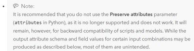

But I wonder why you didn't go to the tool reference first to see the note below.
https://pro.arcgis.com/en/pro-app/latest/tool-reference/data-management/feature-to-polygon.htm
Regarding the "why", the tool existed long before I know it. If you think about all the potential input line/polygon combinations, some make sense to carry over attributes, others don't. When multiple features, such as different lines or polygons or both, form an enclosed area, it may not make sense to write attributes out from one of them or all of them.  I guess it was probably too late to change the tool design once it's released, unfortunately; so we hoped that the Note in the tool reference would help people know not to rely on that parameter.
We are aware of the problem and seek for a future opportunity to create better replacement tool(s).

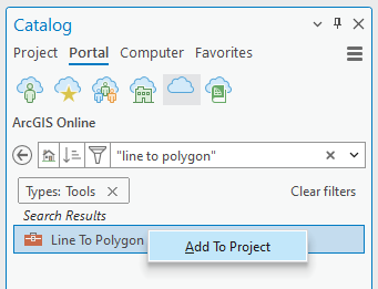

Hi @Katie_Clark ,
You could consider using this geoprocessing sample for converting the lines to polygon. This will maintain the attributes.
https://www.arcgis.com/home/item.html?id=5d99da321d2f4e66a39731a707953b24
If you haven't used a geoprocessing sample in Pro before, it's really easy!
https://pro.arcgis.com/en/pro-app/3.1/help/analysis/geoprocessing/share-analysis/geoprocessing-sampl...

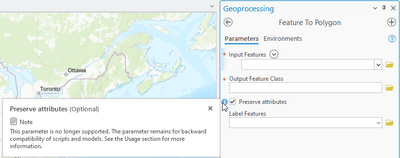

MargaretCrawford
Status changed to: Implemented
This is implemented in ArcGIS Pro 3.4. You will now see legacy notes in parameter hover tips when a parameter is no longer supported or works differently from a previous release.
