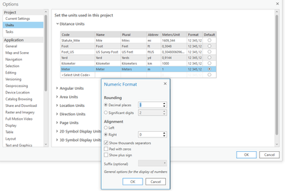

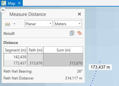

You can change the resolution of the measuring tool in the options menu
KoryKramer

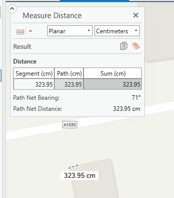

Also, you can add Centimeters to the project's Distance units:
Then measure in centimeters:
