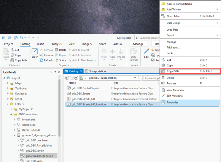

In ArcGIS Pro 3.0, we have added Copy Path to the context men of most item types, including items in databases:
From any catalog window (the Catalog pane, catalog view, catalog view Contents pane), you can right click the item of interest and click Copy Path in its context menu to copy its path.  You have access to this command regardless whether it is a database connection file under a folder (as shown above), or a database connection already added to the project, under the Databases project container.
As to the separate issue of accessing and sharing a set of SDE connection files, the current workaround is to put this set of connection files in a folder on a network drive location that other people (to whom you are sharing these files) can access as well.
