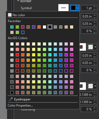

Currently color palette dropdowns do not respond to the keyboard. You cannot open them with the spacebar nor can you navigate between colors with arrow keys. This is a drag on efficiency for anyone who prefers the keyboard over the mouse and may present a barrier to people with disabilities from using the software.
Please implement better support for keyboard users in this area, and throughout the UI. I've come to expect keyboard navigation to just not work in ArcGIS Pro but it would be nice if it behaved like other PC applications in that regard.
