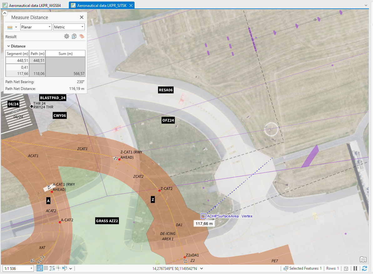

Could you please include G1762 realization of WGS1984  (wkid 9057) into the transformation to S-JTSK for Czech republic area (S_JTSK_To_WGS_1984_1, wkid 1623)? ICAO recommends to use G1762 realization for aeronautical data and it is set as the default target GCS in the Aviation Charting tool that creates AIS geodatabase.
We have troubles to view data in G1762 together with our data in S-JTSK. The positions get shifted about 120m when no transformation is used. No appropriate transformation is offered in ArcGIS Pro.
