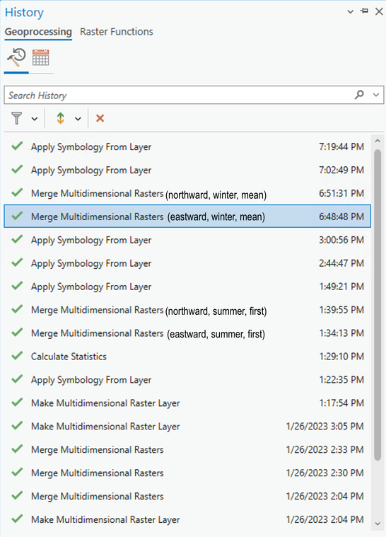

It would be lovely to have the ability to custom rename (alias) tools in the History pane for quick reference at the outermost level, like this:

@JillRKelly I like the idea of a custom note.
We can add a Rename option so that this will be possible.

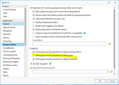

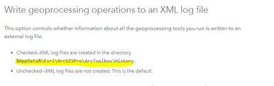

For the second item, there is an option that is available now to write geoprocessing to an .xml log:  Does this satisfy what you are looking for?
https://pro.arcgis.com/en/pro-app/latest/help/analysis/geoprocessing/basics/geoprocessing-history.ht...
wayfaringrob
@JonathanNeal  for me personally, no, since this is something you have to enable beforehand. I haven't had this enabled, so I don't have a way to generate this for any work previously done. I also wouldn't need it for everything.
