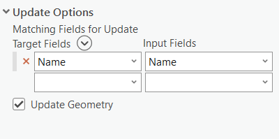

The Append tool will do this in Pro 3.1 using addition Update parameters.
DrewFlater
@Bud We had the Upsert development project in our backlog for awhile and were gathering requirements and researching how the capability could be applied to the Append tool. Seeing your Idea about a year ago, we thought it could be satisfied by the Append tool enhancement. So yes, this Idea pushed us in the direction of doing the Upsert development work in 3.1. There are always many factors at play when it comes to prioritizing our development work, and Ideas are a critical way we can work on and deliver capabilities requested by the user community. So keep up your Ideas and I'm sure more will be implemented in future releases.

@Bud for scenarios which are updated existing, I suggest to use Add Join with the option to only keep matching records, then Calculate Field to calculate the target fields to get the values from the join fields (whichever fields you want). This is done internally as a sort of pre-process within the upsert option of Append, so the same strategy will work well. If there are duplicates in FC-B it will make a 1:m join.
AmeliaBradshaw
Status changed to: Implemented
This Idea has been implemented in ArcGIS Pro 3.1 as an upsert option. The blog Upsert your datasets using the Append tool in ArcGIS Pro 3.1 goes into this functionality in more detail.  Please see the What's New documentation for more new features in Pro 3.1.
