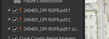

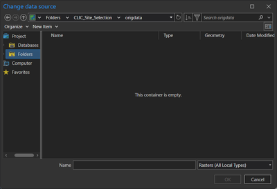

@KoryKramer  having some major issues with this already. Georeferenced two pages of a PDF yesterday, worked great. Today, I get red exclamation points. The file hasn't moved or anything; when I go to re-point the data source, it's not even an option. The dialog box is filtering for 'rasters,' which evidently doesn't include PDFs...oversight?

@KoryKramer  for the fun of it, I hit OK on whatever page it was set to (1), saved, reopened. Immediate error 😑

Sorry to see what you're running into @wayfaringrob Unfortunately it looks like this happens if opening the project from the recent projects list. As a workaround, are you able to open the .aprx directly from the file, instead of Recent Projects?
These are the two related issues that I was able to find:
https://support.esri.com/en-us/bug/the-pdf-layer-is-missing-and-becomes-a-broken-layer-whe-bug-00016...
https://support.esri.com/en-us/bug/unable-to-modify-the-data-source-of-the-pdf-under-set-d-bug-00016...
The team is working on getting them addressed. Hopefully opening the file directly will not show broken layers.
