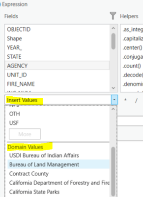

DrewFlater
Status changed to: Implemented
This functionality is delivered in ArcGIS Pro 3.2. You can use a choicelist of domain values in the Insert Values portion of the field calculator expression builder control.
