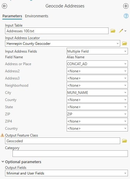

Are there also any requirements for the service? I'm at 3.2.2, and while I can see the category field, it's just blank, i.e. no dropdown options.
ShanaBritt
@JohnNergeBrooklynPark Yes, there are server requirements. The composite needs to be published to Enterprise 11.2 or later in order for the category parameter to not show as a blank field. The other option is to have the County create a multirole locator, but that may not be possible given the participating locators in the composite. They may need to merge some layers together to be able to build a multirole locator. If you can find out what roles the following locators are using I could confirm if the data needs to be modified.
