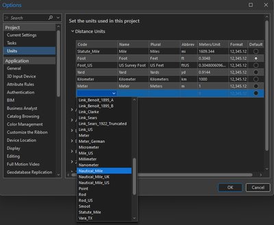

I found this solution, because I had the same issue. you are able to add this yourself.
Here's how:
 under Project, click Options, then units, select distance units, in the table on the bottom row select the unit you would like to be available for the scale bar; nautical miles.
after you say ok in this window you will be able to go back and choose this unit in the scale bar menu.

As @CTalbot showed this is available, you just have to add the units to the project. Closing as already offered.
