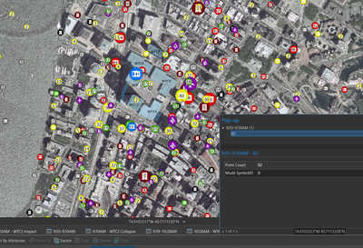

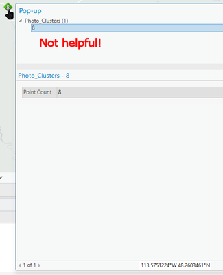

When you click on a clustered feature symbol with the Identify tool (ArcGIS Pro 3.1.2), it only shows you the number of features in the cluster, which is not helpful at all - the symbol already tells you the number of features.
The identify tool should give you a list of the features, the same as when you click on a clump of non-clustered points.
The last time I looked, Binned data worked the same way, and I believe that should also be changed.

I'm looking for this exact feature right now...
Very unhelpful clicking on a cluster and not getting any information about it. I'm looking for exactly this setup that Gerald shared.
