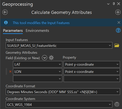

Hi @JonathanNeal Thank for you reply! Due to your comment I've tried to claculate some coordinates again.
This is what I got:
Tool configuration:
Result:
As you can see in the result table, there are 8 decimal places even when the tool is supposedly configured to return only 2, I've tried to change the "SSS.ss" to "SSS.s" or "SSS.sss" manually in the coordinate format, but the tool doesn't run.
I highly appreciate if you have any idea in order to solve this.
Thanks!
