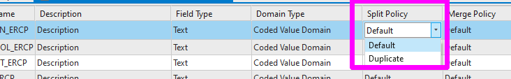

RTPL_AU
@Joshua-Young  ( @KoryKramer FYI re Idea)
The populating of domain values when splitting depends on one of those 'set & forget' settings when creating the domain.
"Default" means delete when split and "Duplicate" is what I would think should be normal behaviour of 'keep everything the same, just split the geometry'.
Idea lodged to have an override setting available in the Split tool dialog.
