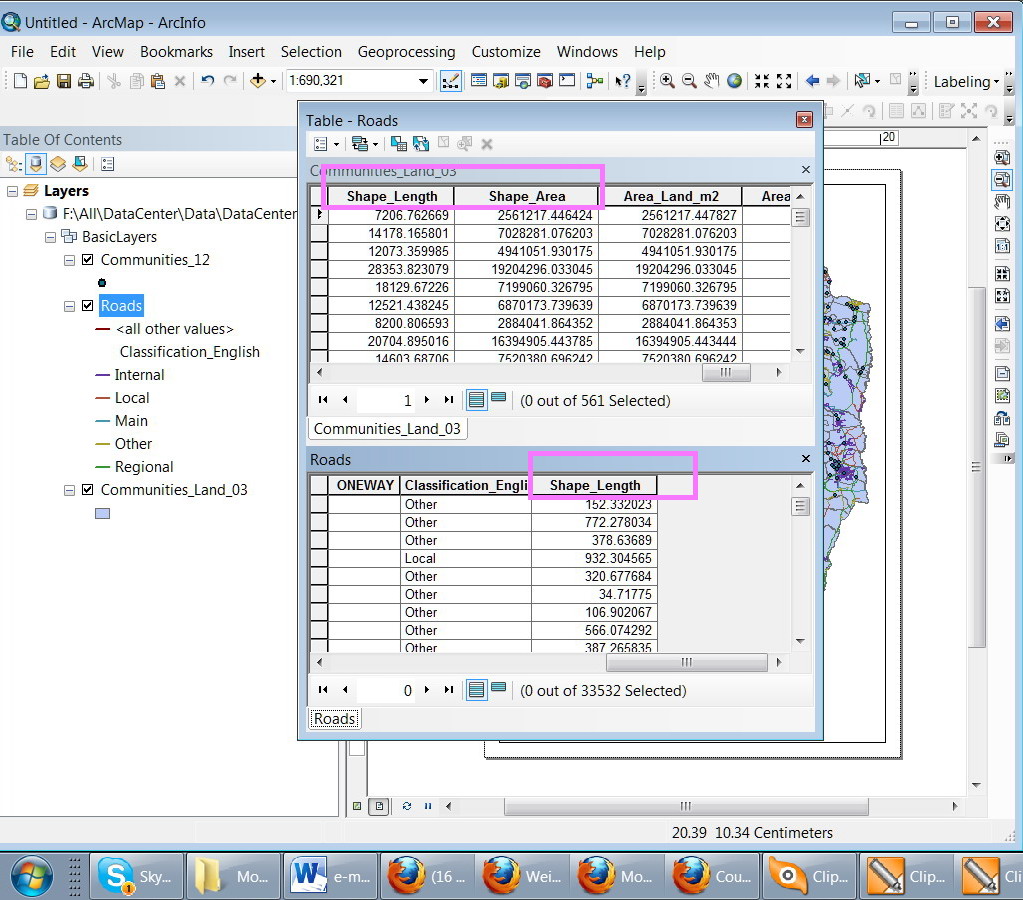

Calculating the X and Y coordinate automatically for the point layer,
I’m not sure why the ArcGIS does calculate:
1.     The area and parimeter in the polygon layer;
2.     The length as a polyline layer
3.     BUT doesn’t create the X and Y coordinate in the Point layer
 0EM30000000CwBX
I do know that there is a tool to calculate the XY coordinate, but I’m wondering why they are not calculated by default!!! In this case, for example, if we move one of the points, then we need to manually update its XY coordinates!!!
Is there any logic behind this?

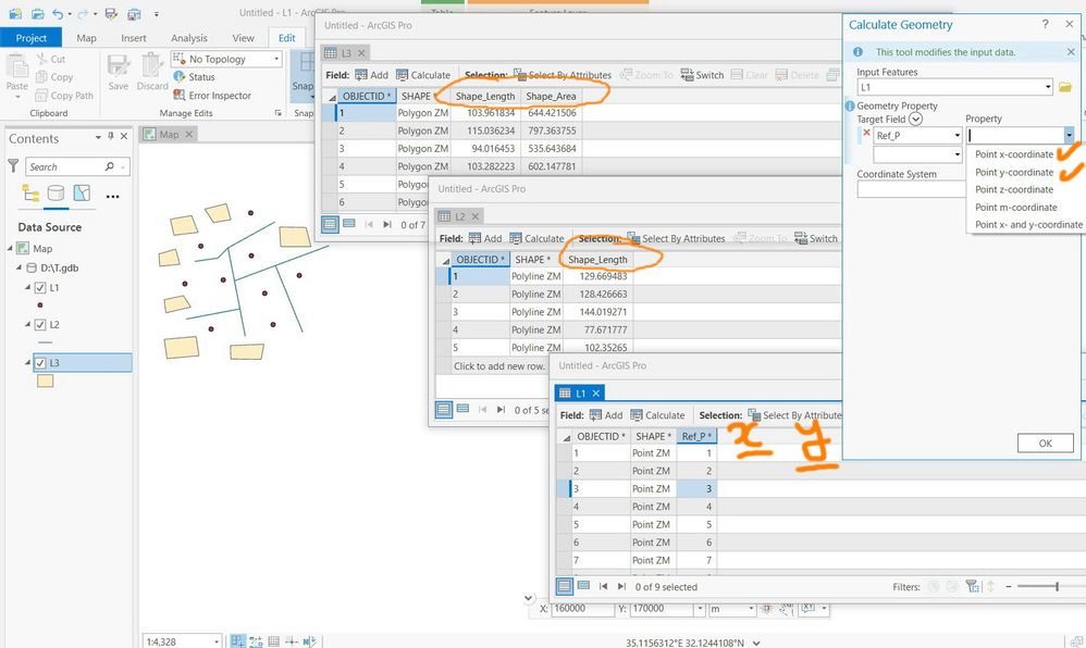

Bud
In the attribute table of a point feature class in ArcGIS Pro:
Give users the option to turn on dynamic, read-only columns that represent each feature's X and Y coordinates.
  • The fields would have similar properties to that of the SHAPE column in the attribute table.
This would be helpful for day-to-day GIS analysis activities. And would eliminate the need for users to calculate or generate the X and Y columns themselves.

JamalNUMAN
Sure Kory. We can add the x and y fields and calculate their values with the available tools.
What I wanted here is to have them added and calculated by default the same way the length and area fields are added for polygon layers and dynamically calculated

This idea is Open, but I wanted to share a blog that I wrote recently showing how to do this with Attribute Rules: Get to the Point: Automatically maintain x,y,z attribute values with ArcGIS Pro and attribute rules
SSWoodward
Status changed to: Closed
Thank you everyone for your contributions to this Idea.
In the coming release of ArcGIS Pro 3.6, Users will have access to a new templated attribute rule geoprocessing tool, Calculate Geometry Properties.  This tool may be used to configure fields containing the x and y coordinate geometry information of point features. The rule is configured by default to trigger on insert and on updates to an existing features' shape field.
Having the x and y coordinate automatically populated for all point feature classes is not currently on the roadmap of enhancements for ArcGIS Pro.
