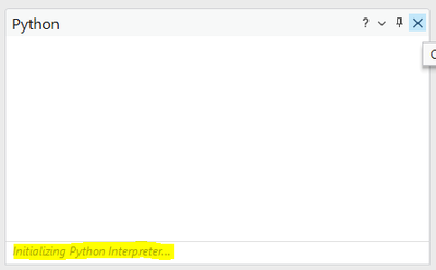

I keep the Python window closed by default.
If I'm using Pro for the first time since restarting my computer, then when I open the Python window, it takes 30 seconds to initialize.
Instead of waiting for the window to initialize, I'm wondering if Python could be automatically initialized by default when ArcGIS Pro first opens.

Because Python takes non-trivial time to initialize itself and the modules loaded by ArcGIS Pro (which include NumPy, ArcPy and a number of other modules), it isn't in the interest of non-Python users to have it initialized at the application startup. Because Pro is used in many different ways, where possible we always want to remove dependencies from its startup because that time will have to be paid by all users regardless of use-case. What we do have in our existing issues is evaluating what we can do to reduce the time it takes to import the default set of Python libraries, or allowing delayed loading of some components which today happen all at once immediately on Python being loaded.
If you know you want Python to load, you can have it happen automatically by keeping the Python window open in your Pro window layout, keeping the Geoprocessing pane expanded, or by using a project containing a Jupyter notebook, in those three cases Python will need to load alongside the application startup.
