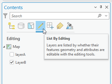

@cmathers You mentioned that you are seeing source features show up in the chip. You can prevent this by turning off the Editability of the source layer while using the tool.
Example: LayerA is my intended source and LayerB is my intended target:
During the "target click", If I click on overlapping features from both layers, I will only have any overlapping features from LayerB showing up in the chip - any features from LayerA will be ignored by the tool.
This how the tool has always worked, but I think introducing the chips has uncovered a bit of confusion about how the tool works - especially if your maps had source features beneath target features in the Contents pane. If that was the case prior to 3.5, those features would have never been optional targets since the topmost feature was the only one available to the tool.
