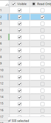

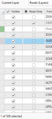

Improvement ideas to handle many fields (multiple digits) in Attribute Table -> Fields
Observation: copy/cut fields will be pasted at the end of the list
Expectation: being able to insert at the current selection before/after the selected row (right click -> insert before/insert after)
Observation: there is no way to quickly move a field from position 4 to position 341. it is possible to drag a field to the desired position, but this is only convenient for a couple of entries:
Expectation: let us insert fields at a specific position by adding a Field Order ID at the left side, then we could right click on the border and select "insert Field(s) at position ###"
