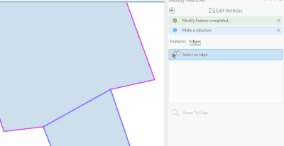

Second,  When I did have a topology on I saw the modify edges tools,furthermore the tool as labeled "select and edge"  I did not want to select an edge, I wanted to select a vertex.
Third, When I opened "select an edge" I noticed that the vertices were in purple so I figured I had the correct tool!  However, when I tried to move the purple vertex nothing happened which reinforced my confusion.  I was not able to  move the vertex in a topology until after I double clicked on the vertex.

2) Once the tool is opened with modify Edges (Topology) selected we are told to select an edge.  The tool opens up and we can select an edge.  However we can also select the vertices as well.  Similar to previous I do not know if "Select and edge" is appropriate.  Is there space to specify "Select and edge or vertex"?
3) When I hovered over a point I noticed it was highlighted.  I tried moving it but nothing happened.  It was not until later that I realized that I needed to double click on the highlighted purple point so that it would turn into a green box which could be moved around.  Is it necessary to have an additional step to switch from the highlighted purple circle to the green box?

Re: #3, perhaps we need some clarification from you. For working with nodes, if you are using Edit Vertices, it should work like this:
1. Select: hover over either a node or edge to show highlighting and then click to select either the node or the edge (you can also hold down N and drag a box to select just the node).
2. Edit: to move a shared vertex (node), hover over the vertex to bring up the move handle, and then move it.
The reason we need the two steps: the first click does the selecting of the edge or node, the second is for actually editing (selecting/adding/removing/moving vertices and segments - if you select an edge).
Re: #4: the next release of the documentation will be updated to include this information.

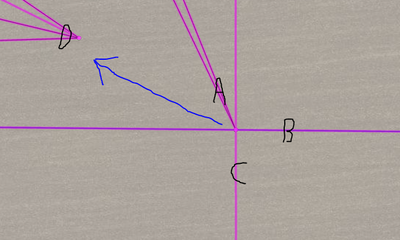

P.S.  Is there a way to disassociate a topology enabled point point from other existing points? In the example below I would like to move the endpoint of parcel A from the intersection of parcel B and C to the endpoint of parcel D.  I cannot just move the vertex as doing so will move the edge of parcels B and C.  I also cannot just turn topology off because my parcels have a topology that ensures that polygons are covered by lines.  The only way I know I can do this now is to:
1) Disable topology.
2) Move the polygon vertex for polygon A.
3)  Move the two lines that are associated with polygon A.
4) Re enable topology.
I would like to know if there is a way to disassociate parcel A and the included lines so that I can move only the endpoint to point D without the need to disable and enable topology.
Thanks!
Scott_Harris
@MarkVolz
See this gif:
I'm unchecking the the topology elements that I don't want to edit.
Does that help?
