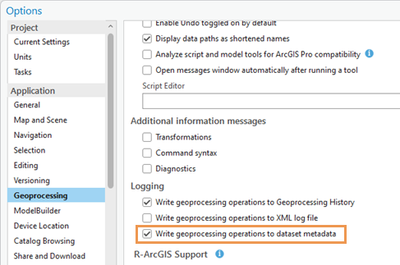

Whether or not the geoprocessing history is recorded in an item's metadata (for feature classes, raster datasets, etc.) is controlled by a setting in the Options dialog box on the Geoprocessing tab as illustrated below. When the Write geoprocessing operations to dataset metadata option is checked, operations that modify a dataset are recorded in the dataset's metadata.
This geoprocessing history is visible in the item's metadata in the Catalog view when you use every metadata style except the default Item Description metadata style.
It is available not just for FGDC CSDGM Metadata, but also for all ISO-based metadata styles that support creating metadata compliant with ISO 19139, ISO 19115-3, INSPIRE, and the North American Profile. In the metadata display, you can find the geoprocessing history underneath any manually-defined lineage for the dataset, as illustrated above. There is no need to switch back and forth between the FGDC CSDGM Metadata style and another metadata style to see this information. When you choose a different metadata style, the metadata display in the Catalog view immediately updates to show you all metadata content.
