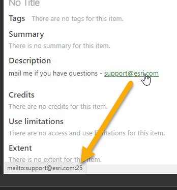

It would be great if ArcGIS Pro would stop appending ":25" to email address mailto links.  E.g., mailto:support@esri.com in metadata link becomes support@esri.com:25 as the email address in the To line of the email.  As a bonus, it would be even greater if that didn't happen in Portal after importing the metadata, too.

Hi @SSWoodward - I see it happening in ArcGIS Pro 3.1.2, various fields.  If I then "share as web layer" the ":25" shows up in the relevant item description field.

Can you show me what is in the description input box when you go to edit the metadata?
TimMinter
SSWoodward
Thanks @TimMinter ,
I can repro that. When you mention 'importing to portal', could you help me understand your workflow a bit more so I can check on that piece of the idea as well.

TimMinter
@SSWoodward
  • ArcGIS Pro > view metadata > metadata > Save As > Save As XML... > Without Sensitive Info > output.xml file
  • Portal > item description > metadata > Overwrite > Open file > output.xml file
