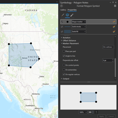

Unfortunately using Marker symbols does not work for polygon lines, so a "show vertices" feature is still desirable in my opinion.
KoryKramer
@MattWilkie1 I just added a marker layer to this polygon symbol and set the marker placement to On vertices. Do you not see the same thing?
MattWilkie1
Oh. my mistake Kory! The "marker placement" control was lower down and collapsed; I didn't see it. Thank you for the correction and screenshot.
KoryKramer
👍Glad that works for you!
