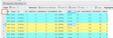

In my map there are some selected data. I switch the Attribute table to the "selected features" view and highlight some of the selected features (in yellow).
After clicking the upper-left corner of the Attribute table I expected to clear the yellow highlight but instead all the selection was cleared (with no opportunity to return back - must re-select all again).
Please, change the behaviour of upper-left corner of Attribute table:
  • In "basic" view clear all selected (blue) features.
  • In "selected features" view clear highlited (yellow) features to selected (change all yellow features to blue)
(This was funkcionality of ArcMap and it can be very difficult to re-create some longer selection process after loosing it by clicking the corner in "selected features" table.)
