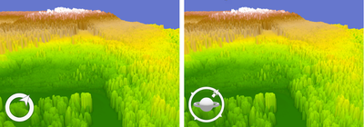

Question for the group - if there was an option to include the on-screen Navigator control (when exporting images and animation-videos) would that meet your needs?
The biggest caveat would be "the appearance and styling of the north arrow overlay would not be configurable" (which matches the 10.x ArcScene case). We'd clear out all the 'controls and buttons' so it'd just be the actual direction indicator.
Example - the north-only indicator, vs the full 3D indicator styling.
