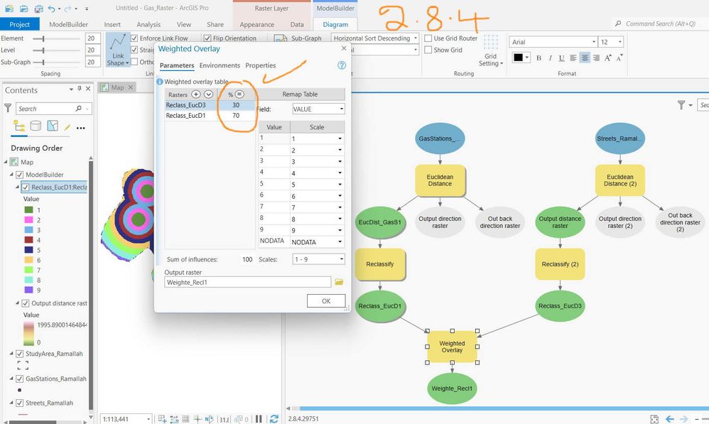

It would be great if the behavior of the “weighted overlay” tool is enhanced such that the link is kept as the weight percent is modified
For example, in the screenshot below, as the weight percent is modified, the link between the “weighted overlay” tool and its outputs is broken!

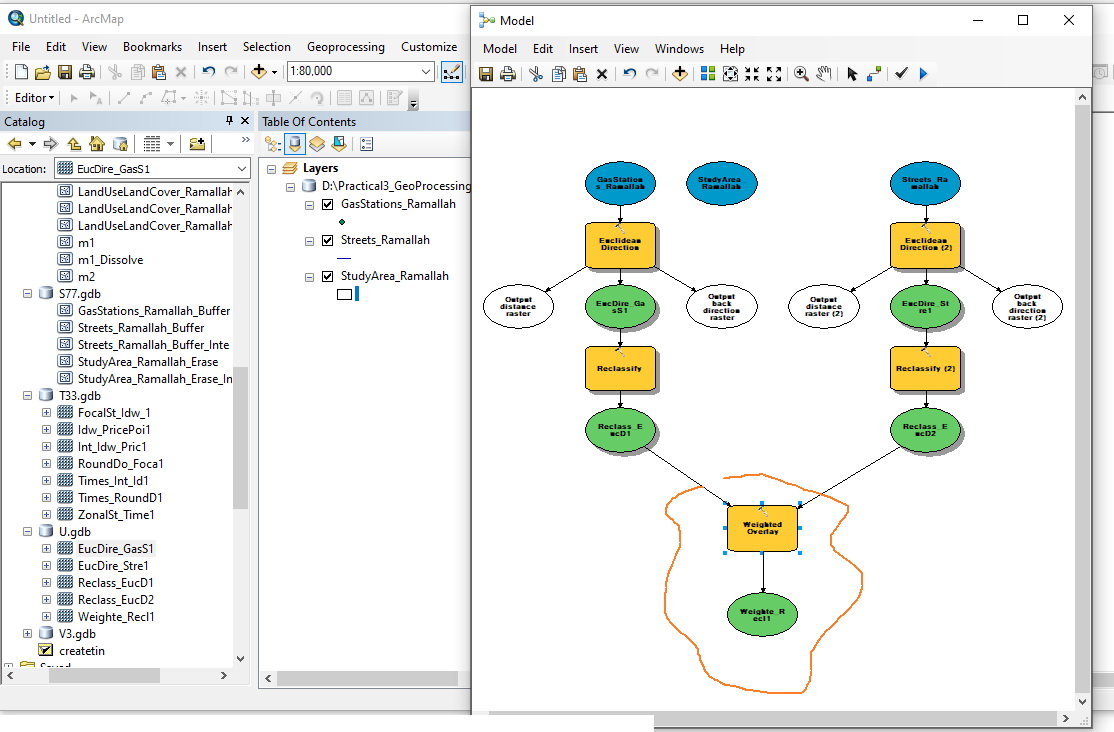

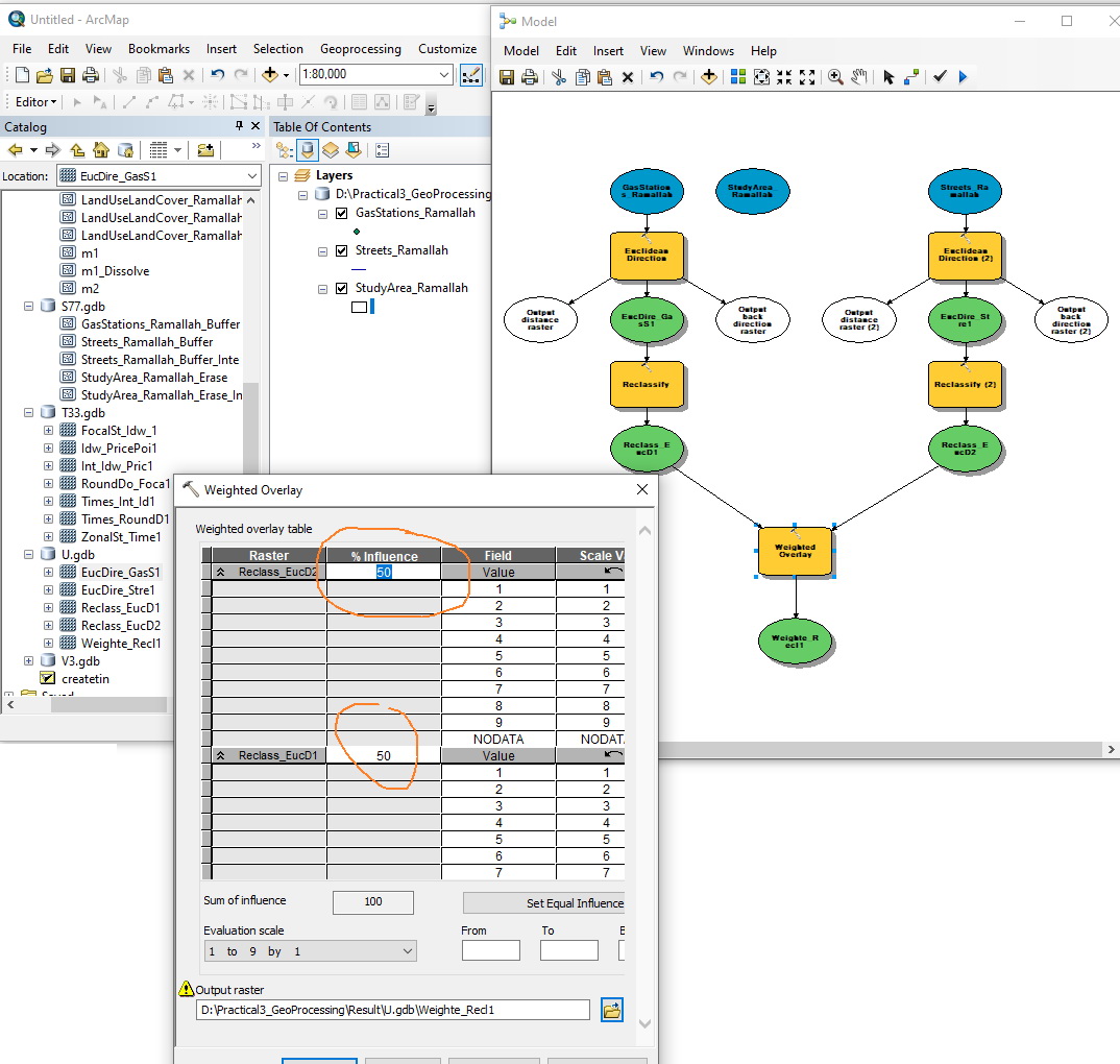

In ArcMap, all goes fine with no issues

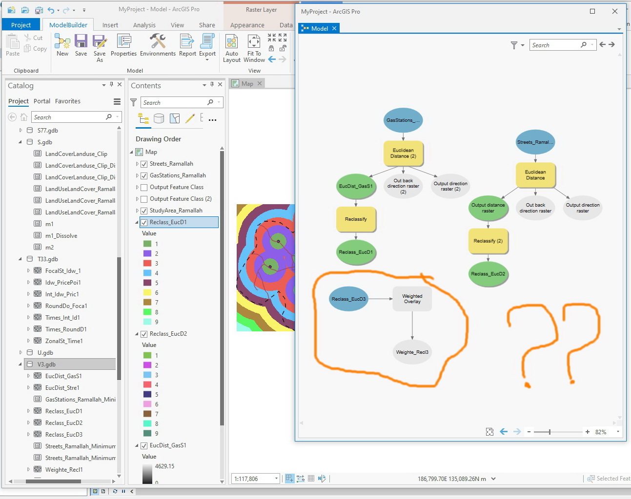

Hi Jamal, I do not see the behavior you're describing.  I see that in the screenshot you provided, you have values that do not add to 100.
Even so, when I looked at this in 2.5.1, I do not see the links being broken between the raster input and the tool.

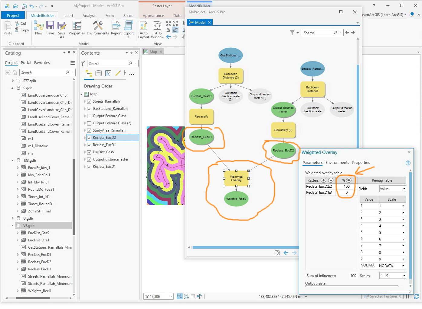

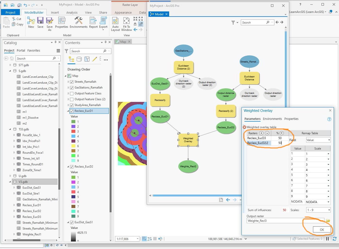

If this is a bug but not “by design” then you can replicate it by considering the little trick below:
You need to add the outputs of the reclassify tools to the content before modifying the influence percent
Steps:
Build the short model shown in the screenshot and run it. It should run successfully
Apply the “add to display” for the outputs of the “reclassify” tools
Now, go back and reverse the order of values in one of the “reclassify” tools
Then go and change the influence percent within the “weighted overlay” tool
The link is broken!

Status changed to: Implemented
This is fixed in ArcGIS Pro 2.8.
