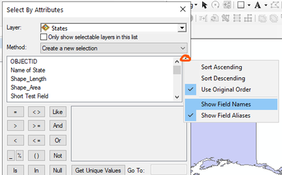

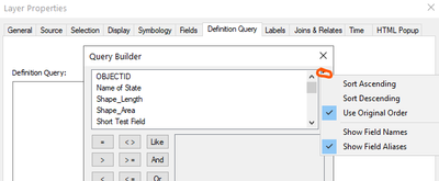

KoryKramer
I realize this is a very old idea, but I stumbled across it just now and figured I'd comment.
It is possible to switch between field name and alias in the query builders.
Examples:
