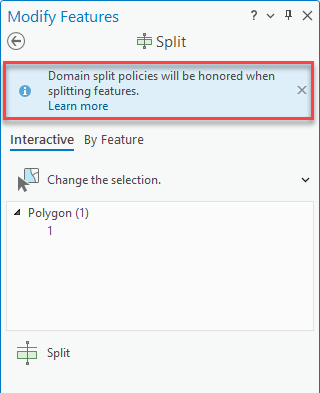

The default Domain behaviour in Pro 3.3.2 when using the split tool on a feature that has fields with Domains is the result has the content of the fields empty (or the domain default code).
Please change the dialog of the Split tool to indicate what the Domains are set to and provide a way to override.

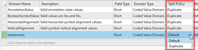

@RTPL_AU What is the Split Policy on the domain within the geodatabase? If it's set to "Default" and the default value for the field with the domain is null, that is what the Split tool will honor.
Check first in the Domains view:

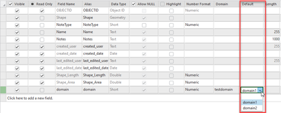

To see what "Default" means for that field, check in the Fields view:
You may want to set the Split Policy on that domain to "Duplicate" or you may want to keep it as "Default" but update the default value of a given field.

Idea changed to request new functionality in Split tool dialog to provide override of Domain setting.
It is not ideal to change the domain settings every time an edit session is opened so it is better to have an option at the tool level to override the domain setting.
