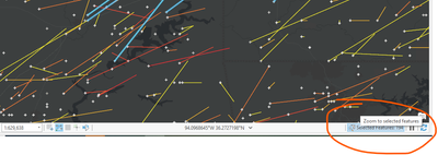

The idea is valid, but I wanted to make sure that you were aware of the Zoom to Selected features button in the lower right corner of the map.
That is a button that will zoom to the selected features in the map - this could be selected features from more than one layer.
GIS-Chops
I did a video on how to do this. It's hidden in plain sight but always available regardless of the active tab.
https://youtu.be/l6jGr06K-ac

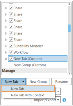

I don't think that this is new in 2.7.  In comparing https://pro.arcgis.com/en/pro-app/2.6/get-started/customize-the-ribbon.htm and https://pro.arcgis.com/en/pro-app/latest/get-started/customize-the-ribbon.htm it seems that both are the same when it comes to not customizing built-in groups.  This may have been part of the work needed to clean up the previous customize experience where a tab was repeated a number of times:
The idea is open.  In the meantime, the selection button in the lower-right can be used, or you could also consider adding it to the Quick-Access Toolbar so that it will always be available regardless of ribbon context.

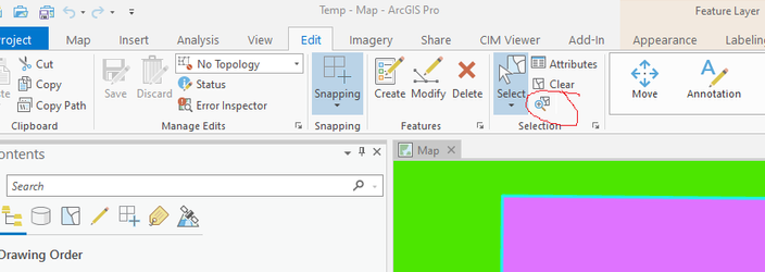

But you have added a new group to the ribbon to achieve this, correct? All I want without having to do ANY customisation is a zoom to select button in the Selection group. I spoof up an example here:

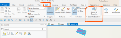

This is what my selection group on the Edit tab looks like:
But I think because I did it when I first started using Pro with an older version my customization of the selection group may be grandfathered into whatever Pro's equivalent of the normal.mxt file is. By the way @KoryKramer , what is that file and where is it located for Pro?
But like I said before, I rarely use it. I have become accustomed to using the tool on the bottom because I don't have to switch tabs to get to it.
