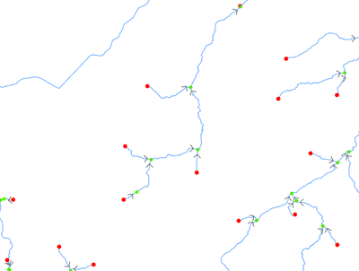

So below is me using a standard arrow symbol at 50% along length of line. I've made nodes and dangles as solid circles (its what I like).
50% along50% along

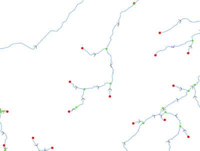

This is me fudging an 80% along symbol, I just prefer it, although difference in minimal? But having the ability to flash on/off an arrow would be very useful.
80% along80% along
