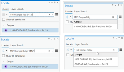

@Jaclyn Do you get the same behavior in the Locate pane in ArcGIS Pro when search for an address on 'Lier Rg' with any of the 3 locators you mentioned above? You should be getting the same behavior with the local locator as you do with the service. I get matches no matter what street type I use for a locator built in 2.7.3 and use in the Locate pane.
Data:
Locate pane:

In the Locate pane in ArcGIS Pro 2.6.3 when I type in Lier Rg or Lier Ridge, I do get the proper results for both to display as candidates, but when I hit enter only Lier Rg returns results. This is the same in our WebApp Builder apps. Cityworks doesn’t use the Suggest functionality so there are no candidates at all for Lier Ridge and only Lier Rg – enter will return anything. In our Enterprise apps, users are able to select Lier Ridge results instead of hitting enter to get results, but this is the only street type example we’ve found where this needs to be done. It was the same thing a few years back with street types of Circle and Close but in the next software release they were added into the Locator tool xml as aliases which solved the problem. I remember with that request a colleague ticketed Esri but this time I was asked to post here as an Idea. Perhaps if you're getting results at 2.7.3 that I'm not at 2.6.3 it has been added into that release.
After hitting Enter:
Lier Rg Locate.PNGLier Rg Locate.PNGLier Ridge Locate.PNGLier Ridge Locate.PNG
