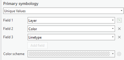

Currently, when you add CAD data from DXF, DWG, etc to a map, Pro will assign a Unique Values symbology to the layer.

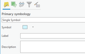

Create an new global option where we can set the default to be Single Symbol symbology for any CAD data added to Pro.
I never use the Esri default in my typical workflow and every time I use CAD data I have to go through the process of changing the symbology.

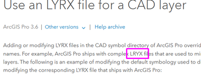

By the way - in the first link they've spelt lyrx wrong.

Thanks for prompting the clarification here, and separately, for catching the typo that needs to be corrected in the documentation.
