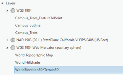

IanMaher11
You can right click a map and go to set the coordinate system for the map, and that will show the layers organized by which spatial reference they are currently using. For example:
