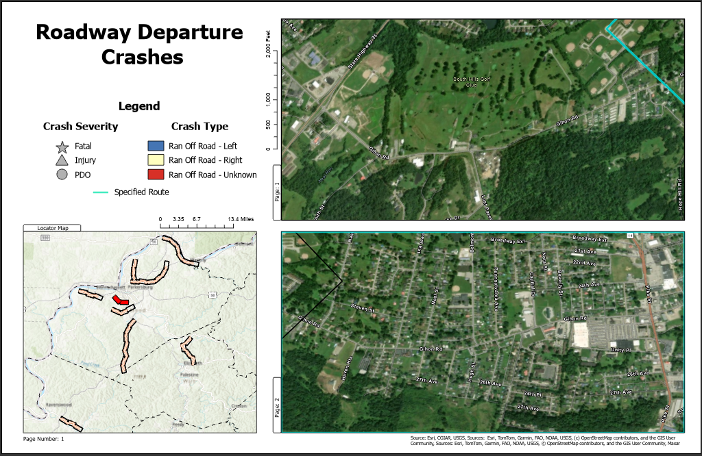

In my example below, I have two map frames on the right that should change on each page. Their extents are shown in the locator map and the next page should be two new view extents. Currently, this type of map is not possible to make a map series: I am limited to one dynamic map frame per map series page, but that'd result in 160 maps, instead of 80 layouts.
That is an interesting case. I would script the page generation. You could have static maps and layouts generate with a script so you can tweak each layout individually (I recently had to do that to the tune of 201 maps and layouts) or you could update the layers in the map and the extents of the single layout then export to PDF so it simulates the map series affect. Setting the extent of a dataframe is a bit roundabout. You cannot directly pan or zoom to a feature but you can get the extent of the feature from its geometry and apply that to the camera property of the dataframe.
