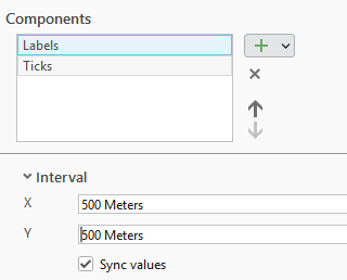

Please provide the ability to group labels and ticks in a map grid in a layout.
The group will then share common properties such as intervals.
In our typical layouts each label has a tick.  Every time we change the map scale we have to change the interval in two places (thank you for being able to sync X & Y intervals). Being able to reduce clicks required for each scale change by 50% will be fantastic.

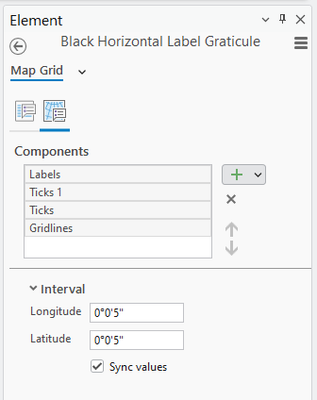

Currently in Pro you can use Shift to multi-select grid components and update the interval for all of them at once. When you multi-select only the common properties are shown, which for grids/labels/ticks is the interval values. It's not exactly what you are asking for, but may be a useful trick for now.

It did not even occur to me to try to grab multiples.
This also means the the background 'understands' grouping & selective variable assignment so my Idea of using app-wide variables is one step closer to being feasible 😀
