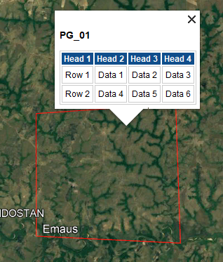

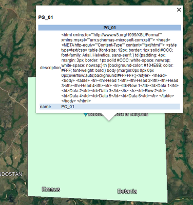

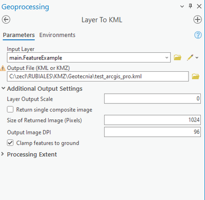

Yeah it's right, I didn't notice the update about this new functionality. However I tried to export the layer to kml file and it didn't catch the "description" field edited in ArcGIS Pro as a table (using html language).
Here some images how the information is shown in the kml generated by QGIS and ArcGIS Pro.
KML from QGIS:
KML from ArcGIS Pro:
There shoud be a way in the tool "Layer to KML" that allow the user to define which field use as "name", "description", etc. Actually these options aren't available on "Additional Output Settings".
