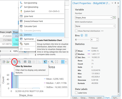

If you right click Shape_Area and select Statistics, you will get a chart and all the statistics in the Chart Properties pane. You can choose to show the stats for all the records or the selected records. It's different from ArcMap but provides more flexibility.  Hope it meets your needs.

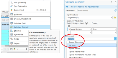

You can add a field, say Area_Hectares, and then right click the field to select Calculate Geometry. This tool allows you to calculate many geometry properties, including Area in specific unit.  It's the same as the geoprocessing tool, Calculate Geometry Attributes.  Hope this helps.

@JasonFuller here is another option for you if you are using ArcGIS Pro 2.8 or later. You can use the Data Engineering view to view statistics for all or selected features - here is the documentation that shows you how. You could use this to view the statistics of an area field you create using the Calculate Geometry Attributes tool, which you can access from the Construct group on the ribbon (or from the Geoprocessing pane). This tool supports unit conversion, so you can create the area field in whichever unit you prefer.
