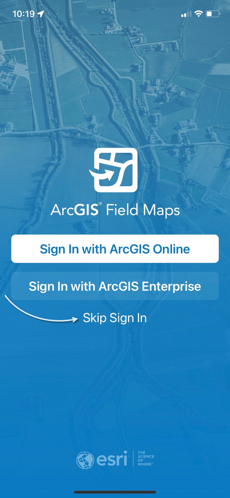

First, let’s see an example of an offline map using ArcGIS Field Maps. If you don’t have the app installed already, start by installing it on your iOS or Android device.  Search for ArcGIS Field Maps in the App or Play store.
Start Explorer and tap Skip Signing In when it launches.

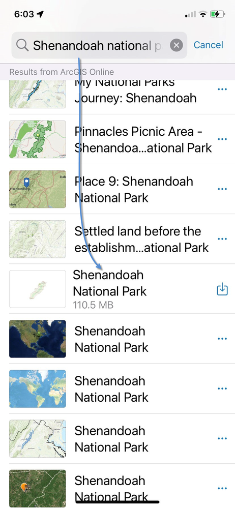

Then search for “Shenandoah National Park” and tap to download the map.
Check out the map to get an idea what is possible: tap features and see information about them, view the map’s layers, measure, or draw markup on the map. If you are new to Field Maps, take a look at Get started and try some of the things called out there using this offline map.
