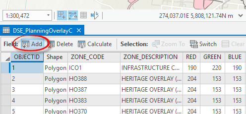

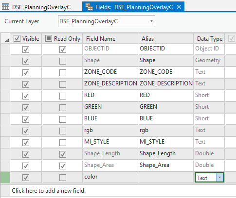

Step 1: Firstly, we need to create a new text (STRING) field:
Add a field in the Fields Designer or use a geoprocessing tool Add Field.

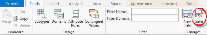

If you’re using the Field Designer in Pro, don’t forget to save your changes:

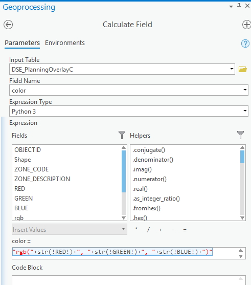

Step 2: Calculate the field values. In my example, I will be using Python. You can also create an expression using Arcade. Some examples are given in this Geonet thread: https://community.esri.com/thread/216350-set-symbol-color-from-rgb-values-in-attribute-table-with-arcade
In my case, I used the following expression: "rgb("+str(!RED!)+", "+str(!GREEN!)+", "+str(!BLUE!)+")"
The output in the new color field should look like the following:

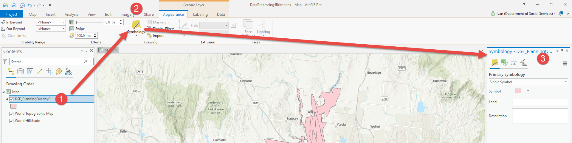

- Highlight the layer under Contents (1 in the graphic that follows)
- Click Symbology (2)
- The Symbology Pane will open (3)

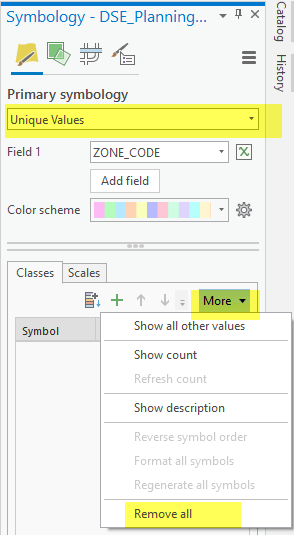

Enable the attribute-driven symbology (based on the combined RGB values). Unless you have a subtype field defined in the feature class, your starting point will be something similar to this:
- Symbolise with Unique Value, remove all of the symbols listed
- Check the Allow symbol property connections option under the Vary symbology by attribute tab
- Return to the Primary Symbology tab, click the More drop down and select Show All Other Values.

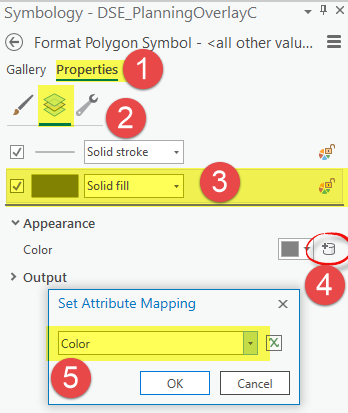

- In the Classes section, right click on the <all other values> value and then select Format Symbol(s) (double-click on the colored rectangle)
- Go to Properties (#1 on the screenshot below) > Layers (2), then select the fill symbol (3).
- Under Appearance, select the database icon (4) to define the attribute to map, and select Color (5) or whatever you named that text field with the combined RGB colors.
- Click ok then apply changes.
