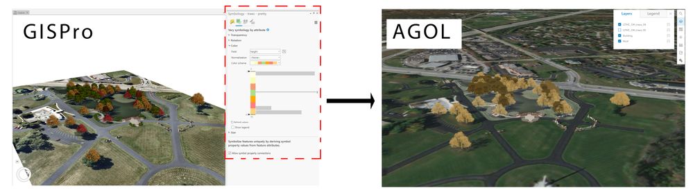

Hi there @Anonymous User.
Thank you for the detailed explanation of the process!
I have used the 'Vary Symbology By Attributes' option, and I have encountered an issue:
I have tried to randomly color the 3D trees symbology, and gladly succeeded to do that in GISPro (2.4)
but once I publish it to AGOL - it's reduced to only 2 colors:
Is that something you can assist me with?
Thanks!!
