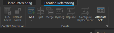

Any reason all the event tools are greyed out?
1432
5
07-11-2024 12:45 PM
Rayn
I have an active LRS license.  I have my LRS and event layers pulled into my APRX.  I just want to split a line event but i cannot get any of the event tools to highlight. I have tried selecting the event, closed and opened the aprx, regenerated my events.  Not sure what else to try?
Any help is appreciated.

I'm pretty sure those tools are only compatible with Branch Versioned data in ArcGIS Enterprise and an APR server extension license https://community.esri.com/t5/arcgis-pipeline-referencing-blog/deployment-scenarios-for-event-editin...

Is your data Branch versioned?
Rayn
sorry should have put that in original post.  Data is in a file geodatabase.
lah
NathanEasley
That's correct, the event editing tools in Pro only work with a service with the linear referencing and version management (branch versioning) capabilities enabled.
Nathan
ArcGIS Pipeline Referencing team
Rayn
I think you are probably right, was testing in fgdb but i guess ill just move things over to enterprise and continue from there.  thanks!
